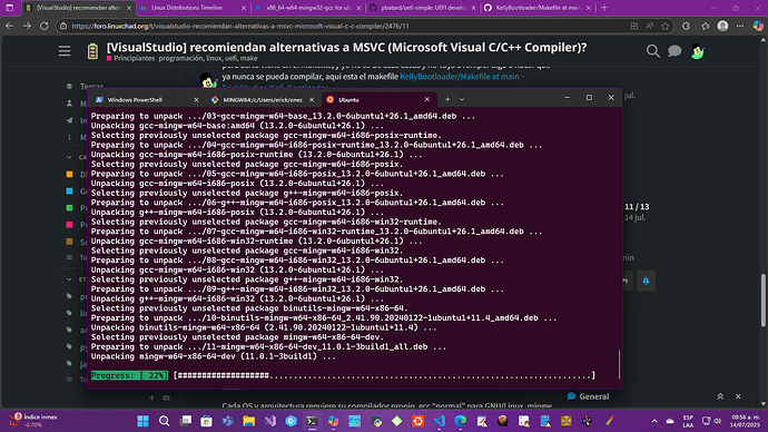

root@windosw-erick:~# donet
Command 'donet' not found, did you mean:
  command 'dotnet' from snap dotnet (9.0.6)
  command 'dotnet' from snap dotnet-sdk (8.0.407)
  command 'dotnet' from deb dotnet-host-8.0 (8.0.14-0ubuntu1~24.04.1)
See 'snap info <snapname>' for additional versions.
root@windosw-erick:~# dotnet
Command 'dotnet' not found, but can be installed with:
snap install dotnet           # version 9.0.6, or
snap install dotnet-sdk       # version 8.0.407
apt  install dotnet-host-8.0  # version 8.0.14-0ubuntu1~24.04.1
root@windosw-erick:~# snap install dotnet
error: This revision of snap "dotnet" was published using classic confinement and thus may perform
       arbitrary system changes outside of the security sandbox that snaps are usually confined to,
       which may put your system at risk.
       If you understand and want to proceed repeat the command including --classic.
root@windosw-erick:~# snap install dotnet -classic
error: unknown flag `c'
root@windosw-erick:~# snap install dotnet --classic
dotnet 9.0.6 from Canonical✓ installed
root@windosw-erick:~# erick
root@windosw-erick:/mnt/c/users/erick# cd onedrive
root@windosw-erick:/mnt/c/users/erick/onedrive# cd erickcraftstudiosmgrchannel
root@windosw-erick:/mnt/c/users/erick/onedrive/erickcraftstudiosmgrchannel# cd "Saved Proyects"
root@windosw-erick:/mnt/c/users/erick/onedrive/erickcraftstudiosmgrchannel/Saved Proyects# cd KellyBootloaderCode
root@windosw-erick:/mnt/c/users/erick/onedrive/erickcraftstudiosmgrchannel/Saved Proyects/KellyBootloaderCode# cd KellyBootloader
root@windosw-erick:/mnt/c/users/erick/onedrive/erickcraftstudiosmgrchannel/Saved Proyects/KellyBootloaderCode/KellyBootloader# make
Makefile:126: *** The selected compiler (x86_64-w64-mingw32-gcc) was not found.  Stop.
el problema es que
e/KellyBootloader# apt install x86_64-w64-mingw32-gcc
Reading package lists... Done
Building dependency tree... Done
Reading state information... Done
E: Unable to locate package x86_64-w64-mingw32-gcc

si me lo instalo pero sigue sucediendo el error root@windosw-erick:/mnt/c/users/erick/onedrive/erickcraftstudiosmgrchannel/Saved Proyects/KellyBootloaderCode/KellyBootloader# make
